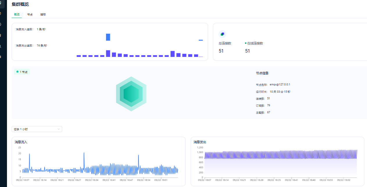

消息流入速率和流出速率与实际一致
消息流入速率机会没用
消息流出速率疯狂增大,100、 120、 到1000

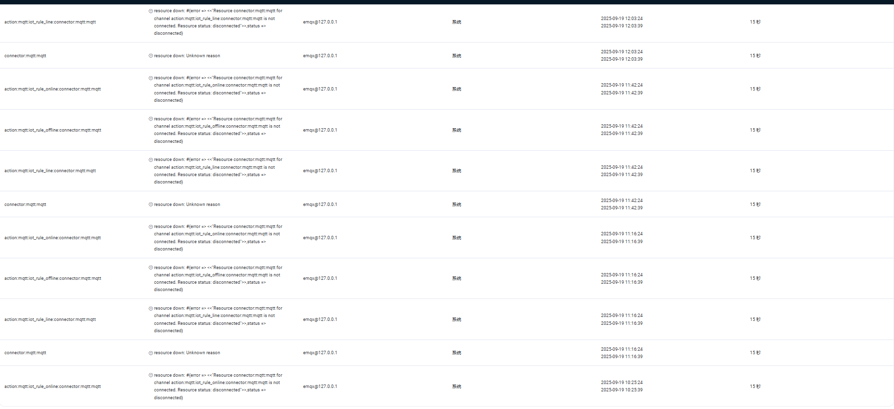

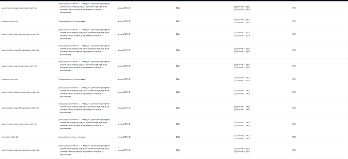

2025-09-22T17:21:43.993786+08:00 [error] msg: connection_error, mfa: emqtt:handle_event/4(1416), error: tcp_error, reason: etimedout
2025-09-22T17:21:50.947129+08:00 [warning] msg: alarm_is_activated, mfa: emqx_alarm:do_actions/3(418), message: <<“resource down: Unknown reason”>>, name: <<“connector:mqtt:mqtt”>>
2025-09-22T17:21:50.947600+08:00 [warning] msg: health_check_failed, mfa: emqx_resource_manager:handle_connected_health_check/1(893), id: <<“connector:mqtt:mqtt”>>, status: disconnected
2025-09-22T17:21:50.947878+08:00 [warning] msg: alarm_is_activated, mfa: emqx_alarm:do_actions/3(418), message: <<“resource down: #{error => <<"Resource connector:mqtt:mqtt for channel action:mqtt:iot_rule_line:connector:mqtt:mqtt is not connected. Resource status: disconnected">>,status => disconnected}”>>, name: <<“action:mqtt:iot_rule_line:connector:mqtt:mqtt”>>
2025-09-22T17:21:50.948168+08:00 [warning] msg: alarm_is_activated, mfa: emqx_alarm:do_actions/3(418), message: <<“resource down: #{error => <<"Resource connector:mqtt:mqtt for channel action:mqtt:iot_rule_offline:connector:mqtt:mqtt is not connected. Resource status: disconnected">>,status => disconnected}”>>, name: <<“action:mqtt:iot_rule_offline:connector:mqtt:mqtt”>>
2025-09-22T17:21:50.948420+08:00 [warning] msg: alarm_is_activated, mfa: emqx_alarm:do_actions/3(418), message: <<“resource down: #{error => <<"Resource connector:mqtt:mqtt for channel action:mqtt:iot_rule_online:connector:mqtt:mqtt is not connected. Resource status: disconnected">>,status => disconnected}”>>, name: <<“action:mqtt:iot_rule_online:connector:mqtt:mqtt”>>
2025-09-22T17:22:05.984832+08:00 [warning] msg: alarm_is_deactivated, mfa: emqx_alarm:do_actions/3(424), name: <<“action:mqtt:iot_rule_line:connector:mqtt:mqtt”>>
2025-09-22T17:22:05.985244+08:00 [warning] msg: alarm_is_deactivated, mfa: emqx_alarm:do_actions/3(424), name: <<“action:mqtt:iot_rule_offline:connector:mqtt:mqtt”>>
2025-09-22T17:22:05.985492+08:00 [warning] msg: alarm_is_deactivated, mfa: emqx_alarm:do_actions/3(424), name: <<“action:mqtt:iot_rule_online:connector:mqtt:mqtt”>>
2025-09-22T17:22:05.985757+08:00 [warning] msg: alarm_is_deactivated, mfa: emqx_alarm:do_actions/3(424), name: <<“connector:mqtt:mqtt”>>

日志中的报错原因是mqtt桥接对端连接失败了
1、EMQX 流入数量几乎没有 但是流出有几百个每秒
2、实际流入数量不止每秒不到1个
3、实际流出页没有你们多

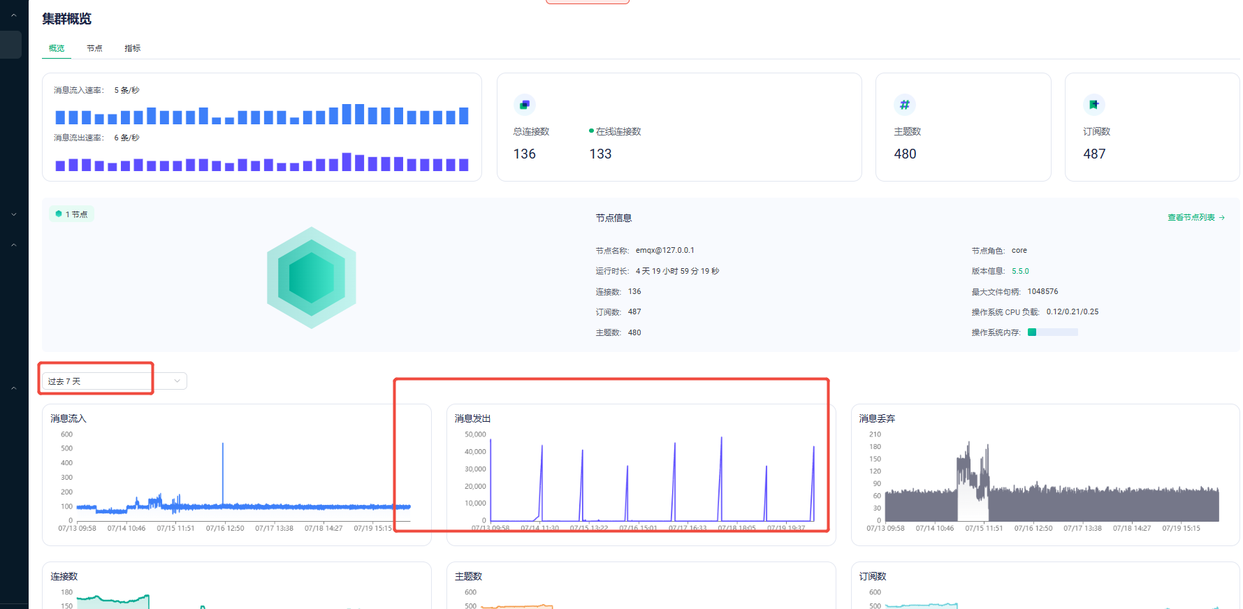

目前又出现诡异的现象了,消息流出突然呈现线性增长

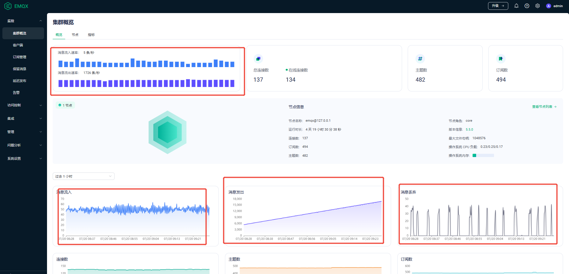

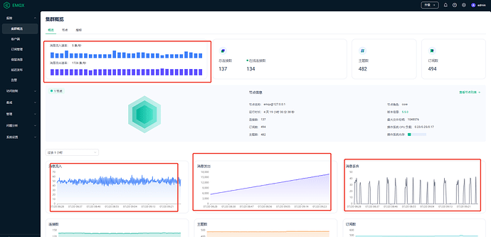

这张图里的两组数据能对上:EMQX 5.5.0 底部历史图默认记录每 10 秒的消息增量,末端约 17,000 条/10 秒,对应上面的 1,726 条/秒;流入约 50 条/10 秒,也对应 5 条/秒。
先看看这三类原因:
  • 发布主题命中了大量订阅,或者存在重叠的 #、+ 通配符订阅。
  • MQTT 桥接或规则的 republish 输出又被订阅、桥接回来了,形成消息回环。
  • QoS 1/2 消费端没有正常回复 ACK,导致 PUBLISH 持续重发。

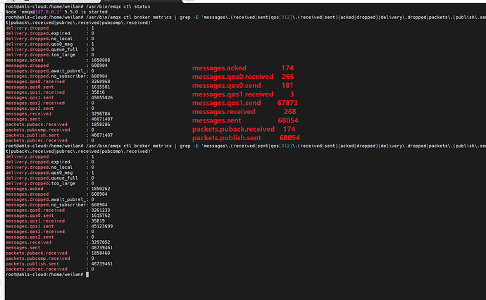

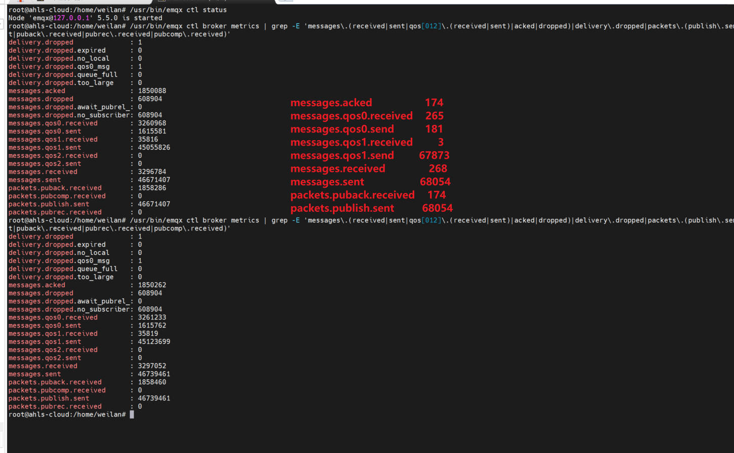

截图里消息丢弃也在周期性尖峰,需要同时确认具体是哪项指标增长。连续执行两次,间隔 30 秒,把相关指标及差值贴出来:
./bin/emqx ctl broker metrics | grep -E 'messages\.(received|sent|qos[012]\.(received|sent)|acked|dropped)|delivery\.dropped|packets\.(publish\.sent|puback\.received|pubrec\.received|pubcomp\.received)'
1、这个是我们真实的环境,因此没有命中大量订阅的情况
2、这个发现是每天的这个时间段会这样
那就奇怪了。那能按上面的命令执行看看么
您,已经截图了并统计相关指标差值
通过这些差值可以明确了:EMQX 在大量发送 QoS 1 消息,而且绝大多数没有及时收到 PUBACK。
按前面约 30 秒的取样:
  • messages.received 增加 268,messages.sent 增加 68,054,出入比约 254 倍。
  • messages.qos1.sent 增加 67,873,占流出消息的 99.7%。
  • packets.puback.received 和 messages.acked 都只增加 174。
  • messages.dropped、delivery.dropped 没有增长,和丢弃无关。
EMQX 5.5.0 的 retry_interval 默认是 30 秒。这组数据很像部分订阅客户端没有回复 PUBACK,飞行窗口里的 QoS 1 消息被周期性重传;每天固定时段出现,优先查该时段在线的订阅端或网络,不是发布端流量。

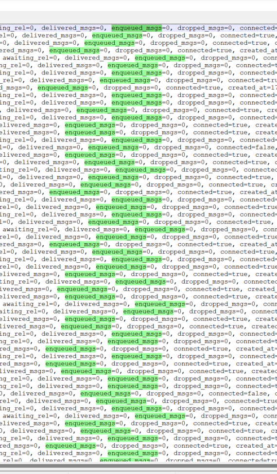

我们当时查看 ,每一个都是这样
Client(, username=admin, peername=, clean_start=false, keepalive=60, session_expiry_interval=43200, subscriptions=6, inflight=0, awaiting_rel=0, delivered_msgs=0, enqueued_msgs=0, dropped_msgs=0, connected=true, created_at=1784095131646, connected_at=1784754910089) 每一个都是这样
当时的截图可以看到每一个enqueued_msgs都是0
这个是指令的执行结果
命令没有输出,说明执行时所有客户端的 inflight 和 enqueued_msgs 都是 0。EMQX 的重传消息一定还在 inflight 窗口里,所以前面“不回 PUBACK 导致持续重传”的判断应该是错的,sorry…

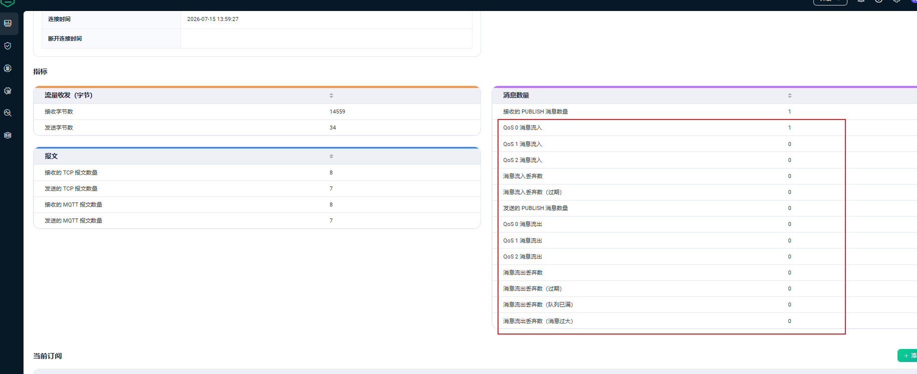

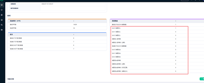

另外我们查看单个客户端没有统计到消息流入和流出的数据异常,要么都是0要么只有一个qos0流入值为1,很多个客户端都这样,实际上设备是在上报数据的
