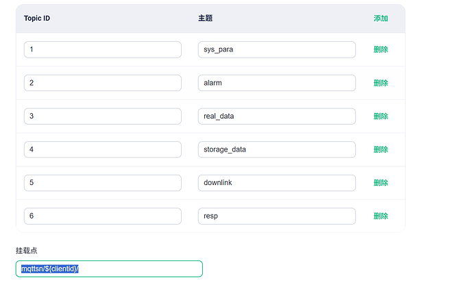

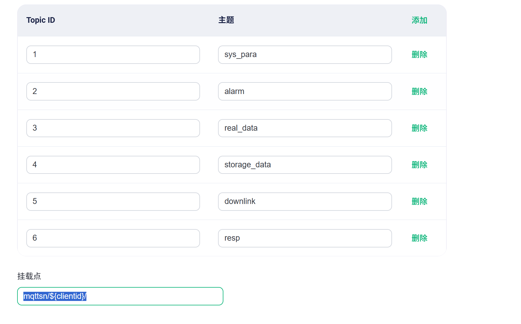

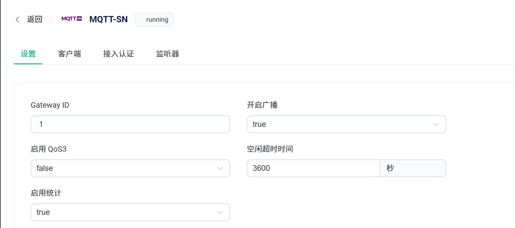

  1. 启用Mqttsn网关,配置挂载点:mqttsn/${clientid}/
