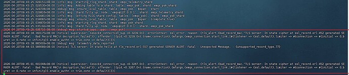

2026-04-18T12:46:52.611295+08:00 [notice] supervisor: {esockd_connection_sup,<0.3400.0>}, errorContext: ssl_error, reason: {tls_alert,{bad_record_mac,“TLS server: In state cipher at ssl_record.erl:452 generated SERVER ALERT: Fatal - Bad Record MAC\n decryption_failed”}}, offender: [{pid,<0.3400.0>},{name,connection},{mfargs,{emqx_connection,start_link,[#{listener => {ssl,default},limiter => #{connection => #{initial => 0,burst => 0,rate => infinity}},enable_authn => true,zone => default}]}}]

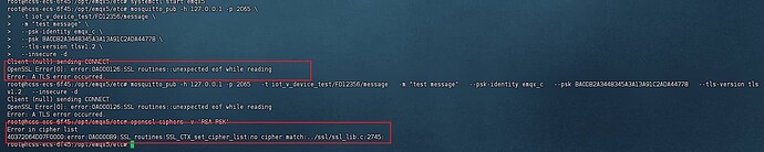

如果还报 bad_record_mac,贴两段输出:
  1. mosquitto_pub ... -d 全量输出
  2. openssl ciphers -v 'RSA-PSK' 输出(确认客户端 OpenSSL 真支持这些套件)

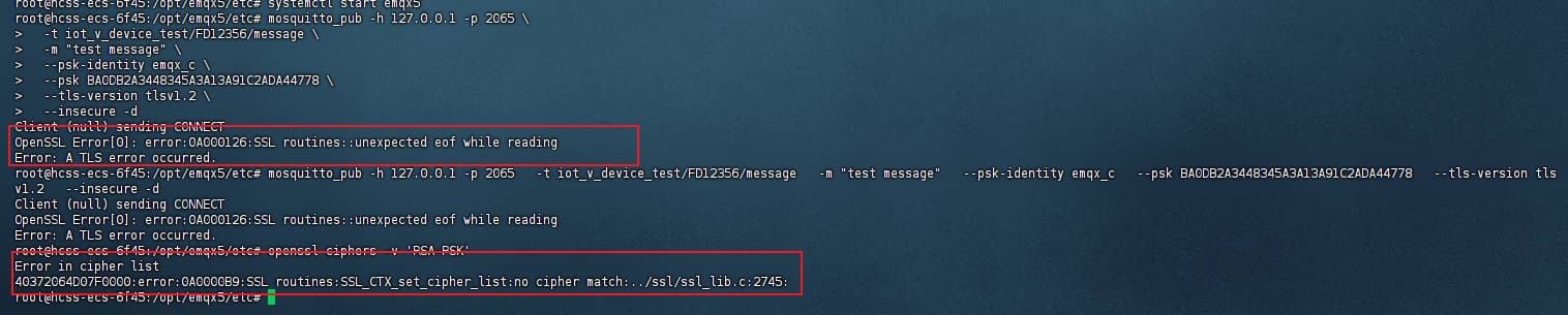

首先感谢您的回复
emqx.conf 配置:
psk_authentication {
enable = true
separator = “:”
init_file = “/opt/emqx5/etc/psk_file.txt”
include “listeners_psk.conf”
listeners_psk.conf
listeners.ssl.default {
bind = “0.0.0.0:2065”
enable = true
ssl_options {
versions = [“tlsv1.2”, “tlsv1.1”, “tlsv1”]
ciphers = [
“RSA-PSK-AES256-GCM-SHA384”,
“RSA-PSK-AES256-CBC-SHA384”,
“RSA-PSK-AES128-GCM-SHA256”,
“RSA-PSK-AES128-CBC-SHA256”,
“RSA-PSK-AES256-CBC-SHA”,
“RSA-PSK-AES128-CBC-SHA”
verify = verify_none
fail_if_no_peer_cert = false
psk_file.txt
emqx_c:BA0DB2A3448345A3A13A91C2ADA44778
测试代码:
log
另外:我用 stunnel 做为psk 认证 测试是可以的;设备也能正常连接
  • 不要在没证书时用 RSA-PSK-*。没配 certfile/keyfile 就先只用 PSK-*。
    PSK Authentication | EMQX Enterprise Docs
  • 把 --psk 改成 psk_file 里那串文本的 ASCII hex。如果你真实的 psk_file.txt 真的是:
    psk-device:b865523d4db1a06aa2c8ac07d605d789
那 mosquitto 里应该转成 hex-decoded,看下面这个回答
非常感谢,按着您说的这种 ASCII HEX 是可以的(每个字符转 HEX),多谢!
