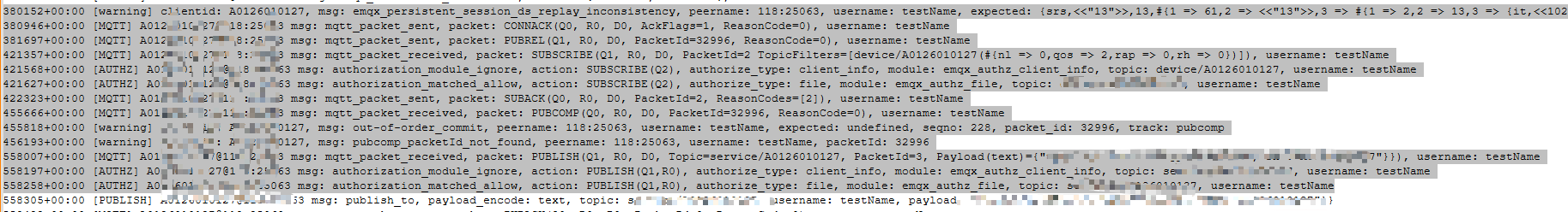

设备mqtt经常重连+消费消息失败
  • EMQX 版本:开源版emqx:5.8.7
  • 操作系统版本:centos:7
这是某个设备的日志信息,目前的情况是1、设备经常重连2、消费qos2消息失败,我不知道是消费消息的时候设备重连的问题导致再次重连会话出问题还是怎么情况,我只看出来packet_id=32996有问题。 设备端代码是cleanSession设置成false 然后消费的消息级别是qos2,帮忙减排查下问题 谢谢。

  1. 确认没有多个设备/线程用同一个 clientId 因为我们的设备都是用sn作为clientId使用 然后嵌入式代码都是用一个线程重连
  2. 这是日志原文也是通过面板工具的日志跟踪该clientId的
    emqx@12-trace_A0126010127_2026-02-10.zip (2.0 KB)

4、这是详细日志:2026-02-11T09:21:05.306849+00:00 [MQTT] testSN@118:23760 msg: mqtt_packet_received, packet: PUBLISH(Q1, R0, D0, Topic=service/testSN, PacketId=64, Payload(text)={“type”:1,“data”:{“quantityElectricity”:38,“powerStatus”:2,“wifiSignalStrength”:3,“wifiName”:“ChinaNet”,“sn”:“testSN”,“volume”:6,“switchStatus”:2}}), username: testName
2026-02-11T09:21:05.307091+00:00 [PUBLISH] testSN@118:23760 msg: publish_to, payload_encode: text, topic: service/testSN, username: testName, payload: {“type”:1,“data”:{“quantityElectricity”:38,“powerStatus”:2,“wifiSignalStrength”:3,“wifiName”:“ChinaNet”,“sn”:“testSN”,“volume”:6,“switchStatus”:2}}
2026-02-11T09:21:05.307228+00:00 [MQTT] testSN@118:23760 msg: mqtt_packet_sent, packet: PUBACK(Q0, R0, D0, PacketId=64, ReasonCode=0), username: testName
2026-02-11T09:21:53.376704+00:00 [MQTT] testSN@118:25063 msg: mqtt_packet_received, packet: CONNECT(Q0, R0, D0, ClientId=testSN, ProtoName=MQTT, ProtoVsn=4, CleanStart=false, KeepAlive=60, Username=testName, Password=******), username: testName
2026-02-11T09:21:53.376904+00:00 [AUTHN] testSN@118:25063 msg: authenticator_result, authenticator: password_based:built_in_database, result: {ok,#{is_superuser => false}}, username: testName
2026-02-11T09:21:53.377014+00:00 [AUTHN] testSN@118:25063 msg: authentication_result, reason: chain_result, result: {stop,{ok,#{is_superuser => false}}}, username: testName
2026-02-11T09:21:53.377766+00:00 [SOCKET] testSN@118:23760 msg: emqx_connection_terminated, reason: {shutdown,takenover}, username: testName
2026-02-11T09:21:53.380152+00:00 [warning] clientid: testSN, msg: emqx_persistent_session_ds_replay_inconsistency, peername: 118:25063, username: testName, expected: {srs,<<“13”>>,13,#{1 => 61,2 => <<“13”>>,3 => #{1 => 2,2 => 13,3 => {it,<<102,82,247,27,74,40,30,78>>,1770603683293999,<<“testSN”>>,}}},#{1 => 61,2 => <<“13”>>,3 => #{1 => 2,2 => 13,3 => {it,<<102,82,247,27,74,40,30,78>>,1770796779383000,<<“testSN”>>,}}},1,18,227,18,228,false,3}, got: {srs,<<“13”>>,13,#{1 => 61,2 => <<“13”>>,3 => #{1 => 2,2 => 13,3 => {it,<<102,82,247,27,74,40,30,78>>,1770603683293999,<<“testSN”>>,}}},#{1 => 61,2 => <<“13”>>,3 => #{1 => 2,2 => 13,3 => {it,<<102,82,247,27,74,40,30,78>>,1770790304944000,<<“testSN”>>,}}},1,18,227,18,228,false,3}
2026-02-11T09:21:53.380946+00:00 [MQTT] testSN@118:25063 msg: mqtt_packet_sent, packet: CONNACK(Q0, R0, D0, AckFlags=1, ReasonCode=0), username: testName
2026-02-11T09:21:53.381697+00:00 [MQTT] testSN@118:25063 msg: mqtt_packet_sent, packet: PUBREL(Q1, R0, D0, PacketId=32996, ReasonCode=0), username: testName
2026-02-11T09:21:53.421357+00:00 [MQTT] testSN@118:25063 msg: mqtt_packet_received, packet: SUBSCRIBE(Q1, R0, D0, PacketId=2 TopicFilters=[device/testSN(#{nl => 0,qos => 2,rap => 0,rh => 0})]), username: testName
2026-02-11T09:21:53.421568+00:00 [AUTHZ] testSN@118:25063 msg: authorization_module_ignore, action: SUBSCRIBE(Q2), authorize_type: client_info, module: emqx_authz_client_info, topic: device/testSN, username: testName
2026-02-11T09:21:53.421627+00:00 [AUTHZ] testSN@118:25063 msg: authorization_matched_allow, action: SUBSCRIBE(Q2), authorize_type: file, module: emqx_authz_file, topic: device/testSN, username: testName
2026-02-11T09:21:53.422323+00:00 [MQTT] testSN@118:25063 msg: mqtt_packet_sent, packet: SUBACK(Q0, R0, D0, PacketId=2, ReasonCodes=[2]), username: testName
2026-02-11T09:21:53.455666+00:00 [MQTT] testSN@118:25063 msg: mqtt_packet_received, packet: PUBCOMP(Q0, R0, D0, PacketId=32996, ReasonCode=0), username: testName
2026-02-11T09:21:53.455818+00:00 [warning] clientid: testSN, msg: out-of-order_commit, peername: 118:25063, username: testName, expected: undefined, seqno: 228, packet_id: 32996, track: pubcomp
2026-02-11T09:21:53.456193+00:00 [warning] clientid: testSN, msg: pubcomp_packetId_not_found, peername: 118:25063, username: testName, packetId: 32996
2026-02-11T09:21:56.558007+00:00 [MQTT] testSN@118:25063 msg: mqtt_packet_received, packet: PUBLISH(Q1, R0, D0, Topic=service/testSN, PacketId=3, Payload(text)={“type”:4,“data”:{“type”:“D0004”,“sn”:“testSN”}}), username: testName
2026-02-11T09:21:56.558197+00:00 [AUTHZ] testSN@118:25063 msg: authorization_module_ignore, action: PUBLISH(Q1,R0), authorize_type: client_info, module: emqx_authz_client_info, topic: service/testSN, username: testName
2026-02-11T09:21:56.558258+00:00 [AUTHZ] testSN@118:25063 msg: authorization_matched_allow, action: PUBLISH(Q1,R0), authorize_type: file, module: emqx_authz_file, topic: service/testSN, username: testName
2026-02-11T09:21:56.558305+00:00 [PUBLISH] testSN@118:25063 msg: publish_to, payload_encode: text, topic: service/testSN, username: testName, payload: {“type”:4,“data”:{“type”:“D0004”,“sn”:“testSN”}}
2026-02-11T09:21:56.558422+00:00 [MQTT] testSN@118:25063 msg: mqtt_packet_sent, packet: PUBACK(Q0, R0, D0, PacketId=3, ReasonCode=0), username: testName
2026-02-11T09:21:59.404467+00:00 [MQTT] testSN@118:25063 msg: mqtt_packet_received, packet: PUBLISH(Q1, R0, D0, Topic=service/testSN, PacketId=4, Payload(text)={“type”:4,“data”:{“type”:“D0004”,“sn”:“testSN”}}), username: testName
2026-02-11T09:21:59.404648+00:00 [PUBLISH] testSN@118:25063 msg: publish_to, payload_encode: text, topic: service/testSN, username: testName, payload: {“type”:4,“data”:{“type”:“D0004”,“sn”:“testSN”}}
2026-02-11T09:21:59.404785+00:00 [MQTT] testSN@118:25063 msg: mqtt_packet_sent, packet: PUBACK(Q0, R0, D0, PacketId=4, ReasonCode=0), username: testName
2026-02-11T09:22:08.052970+00:00 [MQTT] testSN@118:25063 msg: mqtt_packet_received, packet: PUBLISH(Q1, R0, D0, Topic=service/testSN, PacketId=5, Payload(text)={“type”:1,“data”:{“quantityElectricity”:18,“powerStatus”:2,“wifiSignalStrength”:3,“wifiName”:“ChinaNet”,“sn”:“testSN”,“volume”:6,“switchStatus”:2}}), username: testName
2026-02-11T09:22:08.053273+00:00 [PUBLISH] testSN@118:25063 msg: publish_to, payload_encode: text, topic: service/testSN, username: testName, payload: {“type”:1,“data”:{“quantityElectricity”:18,“powerStatus”:2,“wifiSignalStrength”:3,“wifiName”:“ChinaNet”,“sn”:“testSN”,“volume”:6,“switchStatus”:2}}
2026-02-11T09:22:08.053454+00:00 [MQTT] testSN@118:25063 msg: mqtt_packet_sent, packet: PUBACK(Q0, R0, D0, PacketId=5, ReasonCode=0), username: testName
2026-02-11T09:22:14.314907+00:00 [MQTT] testSN@118:25063 msg: mqtt_packet_received, packet: PUBLISH(Q1, R0, D0, Topic=service/testSN, PacketId=6, Payload(text)={“type”:1,“data”:{“quantityElectricity”:17,“powerStatus”:2,“wifiSignalStrength”:3,“wifiName”:“ChinaNet”,“sn”:“testSN”,“volume”:6,“switchStatus”:2}}), username: testName
2026-02-11T09:22:14.315240+00:00 [PUBLISH] testSN@118:25063 msg: publish_to, payload_encode: text, topic: service/testSN, username: testName, payload: {“type”:1,“data”:{“quantityElectricity”:17,“powerStatus”:2,“wifiSignalStrength”:3,“wifiName”:“ChinaNet”,“sn”:“testSN”,“volume”:6,“switchStatus”:2}}
2026-02-11T09:22:14.315437+00:00 [MQTT] testSN@118:25063 msg: mqtt_packet_sent, packet: PUBACK(Q0, R0, D0, PacketId=6, ReasonCode=0), username: testName
2026-02-11T09:22:20.355745+00:00 [MQTT] testSN@118:25063 msg: mqtt_packet_received, packet: PUBLISH(Q1, R0, D0, Topic=service/testSN, PacketId=7, Payload(text)={“type”:1,“data”:{“quantityElectricity”:13,“powerStatus”:2,“wifiSignalStrength”:3,“wifiName”:“ChinaNet”,“sn”:“testSN”,“volume”:6,“switchStatus”:2}}), username: testName
2026-02-11T09:22:20.356060+00:00 [PUBLISH] testSN@118:25063 msg: publish_to, payload_encode: text, topic: service/testSN, username: testName, payload: {“type”:1,“data”:{“quantityElectricity”:13,“powerStatus”:2,“wifiSignalStrength”:3,“wifiName”:“ChinaNet”,“sn”:“testSN”,“volume”:6,“switchStatus”:2}}
2026-02-11T09:22:20.356283+00:00 [MQTT] testSN@118:25063 msg: mqtt_packet_sent, packet: PUBACK(Q0, R0, D0, PacketId=7, ReasonCode=0), username: testName
2026-02-11T09:22:26.393497+00:00 [MQTT] testSN@118:25063 msg: mqtt_packet_received, packet: PUBLISH(Q1, R0, D0, Topic=service/testSN, PacketId=8, Payload(text)={“type”:1,“data”:{“quantityElectricity”:15,“powerStatus”:2,“wifiSignalStrength”:3,“wifiName”:“ChinaNet”,“sn”:“testSN”,“volume”:6,“switchStatus”:2}}), username: testName
2026-02-11T09:22:26.393766+00:00 [PUBLISH] testSN@118:25063 msg: publish_to, payload_encode: text, topic: service/testSN, username: testName, payload: {“type”:1,“data”:{“quantityElectricity”:15,“powerStatus”:2,“wifiSignalStrength”:3,“wifiName”:“ChinaNet”,“sn”:“testSN”,“volume”:6,“switchStatus”:2}}
2026-02-11T09:22:26.393958+00:00 [MQTT] testSN@118:25063 msg: mqtt_packet_sent, packet: PUBACK(Q0, R0, D0, PacketId=8, ReasonCode=0), username: testName
2026-02-11T09:22:32.433240+00:00 [MQTT] testSN@118:25063 msg: mqtt_packet_received, packet: PUBLISH(Q1, R0, D0, Topic=service/testSN, PacketId=9, Payload(text)={“type”:1,“data”:{“quantityElectricity”:14,“powerStatus”:2,“wifiSignalStrength”:3,“wifiName”:“ChinaNet”,“sn”:“testSN”,“volume”:6,“switchStatus”:2}}), username: testName
2026-02-11T09:22:32.433477+00:00 [PUBLISH] testSN@118:25063 msg: publish_to, payload_encode: text, topic: service/testSN, username: testName, payload: {“type”:1,“data”:{“quantityElectricity”:14,“powerStatus”:2,“wifiSignalStrength”:3,“wifiName”:“ChinaNet”,“sn”:“testSN”,“volume”:6,“switchStatus”:2}}
2026-02-11T09:22:32.433621+00:00 [MQTT] testSN@118:25063 msg: mqtt_packet_sent, packet: PUBACK(Q0, R0, D0, PacketId=9, ReasonCode=0), username: testName
2026-02-11T09:22:38.676916+00:00 [MQTT] testSN@118:25063 msg: mqtt_packet_received, packet: PUBLISH(Q1, R0, D0, Topic=service/testSN, PacketId=10, Payload(text)={“type”:1,“data”:{“quantityElectricity”:14,“powerStatus”:2,“wifiSignalStrength”:3,“wifiName”:“ChinaNet”,“sn”:“testSN”,“volume”:6,“switchStatus”:2}}), username: testName
2026-02-11T09:22:38.677122+00:00 [PUBLISH] testSN@118:25063 msg: publish_to, payload_encode: text, topic: service/testSN, username: testName, payload: {“type”:1,“data”:{“quantityElectricity”:14,“powerStatus”:2,“wifiSignalStrength”:3,“wifiName”:“ChinaNet”,“sn”:“testSN”,“volume”:6,“switchStatus”:2}}
2026-02-11T09:22:38.677266+00:00 [MQTT] testSN@118:25063 msg: mqtt_packet_sent, packet: PUBACK(Q0, R0, D0, PacketId=10, ReasonCode=0), username: testName
2026-02-11T09:22:44.814849+00:00 [MQTT] testSN@118:25063 msg: mqtt_packet_received, packet: PUBLISH(Q1, R0, D0, Topic=service/testSN, PacketId=11, Payload(text)={“type”:1,“data”:{“quantityElectricity”:13,“powerStatus”:2,“wifiSignalStrength”:3,“wifiName”:“ChinaNet”,“sn”:“testSN”,“volume”:6,“switchStatus”:2}}), username: testName
2026-02-11T09:22:44.815155+00:00 [PUBLISH] testSN@118:25063 msg: publish_to, payload_encode: text, topic: service/testSN, username: testName, payload: {“type”:1,“data”:{“quantityElectricity”:13,“powerStatus”:2,“wifiSignalStrength”:3,“wifiName”:“ChinaNet”,“sn”:“testSN”,“volume”:6,“switchStatus”:2}}
2026-02-11T09:22:44.815364+00:00 [MQTT] testSN@118:25063 msg: mqtt_packet_sent, packet: PUBACK(Q0, R0, D0, PacketId=11, ReasonCode=0), username: testName
2026-02-11T09:22:50.874962+00:00 [MQTT] testSN@118:25063 msg: mqtt_packet_received, packet: PUBLISH(Q1, R0, D0, Topic=service/testSN, PacketId=12, Payload(text)={“type”:1,“data”:{“quantityElectricity”:14,“powerStatus”:2,“wifiSignalStrength”:3,“wifiName”:“ChinaNet”,“sn”:“testSN”,“volume”:6,“switchStatus”:2}}), username: testName
2026-02-11T09:22:50.875195+00:00 [PUBLISH] testSN@118:25063 msg: publish_to, payload_encode: text, topic: service/testSN, username: testName, payload: {“type”:1,“data”:{“quantityElectricity”:14,“powerStatus”:2,“wifiSignalStrength”:3,“wifiName”:“ChinaNet”,“sn”:“testSN”,“volume”:6,“switchStatus”:2}}
2026-02-11T09:22:50.875353+00:00 [MQTT] testSN@118:25063 msg: mqtt_packet_sent, packet: PUBACK(Q0, R0, D0, PacketId=12, ReasonCode=0), username: testName
2026-02-11T09:22:56.926028+00:00 [MQTT] testSN@118:25063 msg: mqtt_packet_received, packet: PUBLISH(Q1, R0, D0, Topic=service/testSN, PacketId=13, Payload(text)={“type”:1,“data”:{“quantityElectricity”:13,“powerStatus”:2,“wifiSignalStrength”:3,“wifiName”:“ChinaNet”,“sn”:“testSN”,“volume”:6,“switchStatus”:2}}), username: testName
2026-02-11T09:22:56.926352+00:00 [AUTHZ] testSN@118:25063 msg: authorization_module_ignore, action: PUBLISH(Q1,R0), authorize_type: client_info, module: emqx_authz_client_info, topic: service/testSN, username: testName
2026-02-11T09:22:56.926421+00:00 [AUTHZ] testSN@118:25063 msg: authorization_matched_allow, action: PUBLISH(Q1,R0), authorize_type: file, module: emqx_authz_file, topic: service/testSN, username: testName
2026-02-11T09:22:56.926495+00:00 [PUBLISH] testSN@118:25063 msg: publish_to, payload_encode: text, topic: service/testSN, username: testName, payload: {“type”:1,“data”:{“quantityElectricity”:13,“powerStatus”:2,“wifiSignalStrength”:3,“wifiName”:“ChinaNet”,“sn”:“testSN”,“volume”:6,“switchStatus”:2}}
2026-02-11T09:22:56.926653+00:00 [MQTT] testSN@118:25063 msg: mqtt_packet_sent, packet: PUBACK(Q0, R0, D0, PacketId=13, ReasonCode=0), username: testName
2026-02-11T09:23:02.990263+00:00 [MQTT] testSN@118:25063 msg: mqtt_packet_received, packet: PUBLISH(Q1, R0, D0, Topic=service/testSN, PacketId=14, Payload(text)={“type”:1,“data”:{“quantityElectricity”:15,“powerStatus”:2,“wifiSignalStrength”:3,“wifiName”:“ChinaNet”,“sn”:“testSN”,“volume”:6,“switchStatus”:2}}), username: testName
2026-02-11T09:23:02.990524+00:00 [PUBLISH] testSN@118:25063 msg: publish_to, payload_encode: text, topic: service/testSN, username: testName, payload: {“type”:1,“data”:{“quantityElectricity”:15,“powerStatus”:2,“wifiSignalStrength”:3,“wifiName”:“ChinaNet”,“sn”:“testSN”,“volume”:6,“switchStatus”:2}}
2026-02-11T09:23:02.990695+00:00 [MQTT] testSN@118:25063 msg: mqtt_packet_sent, packet: PUBACK(Q0, R0, D0, PacketId=14, ReasonCode=0), username: testName
2026-02-11T09:23:09.076525+00:00 [MQTT] testSN@118:25063 msg: mqtt_packet_received, packet: PUBLISH(Q1, R0, D0, Topic=service/testSN, PacketId=15, Payload(text)={“type”:1,“data”:{“quantityElectricity”:14,“powerStatus”:2,“wifiSignalStrength”:3,“wifiName”:“ChinaNet”,“sn”:“testSN”,“volume”:6,“switchStatus”:2}}), username: testName
2026-02-11T09:23:09.076744+00:00 [PUBLISH] testSN@118:25063 msg: publish_to, payload_encode: text, topic: service/testSN, username: testName, payload: {“type”:1,“data”:{“quantityElectricity”:14,“powerStatus”:2,“wifiSignalStrength”:3,“wifiName”:“ChinaNet”,“sn”:“testSN”,“volume”:6,“switchStatus”:2}}
2026-02-11T09:23:09.076918+00:00 [MQTT] testSN@118:25063 msg: mqtt_packet_sent, packet: PUBACK(Q0, R0, D0, PacketId=15, ReasonCode=0), username: testName
2026-02-11T09:23:15.119515+00:00 [MQTT] testSN@118:25063 msg: mqtt_packet_received, packet: PUBLISH(Q1, R0, D0, Topic=service/testSN, PacketId=16, Payload(text)={“type”:1,“data”:{“quantityElectricity”:13,“powerStatus”:2,“wifiSignalStrength”:3,“wifiName”:“ChinaNet”,“sn”:“testSN”,“volume”:6,“switchStatus”:2}}), username: testName
2026-02-11T09:23:15.119751+00:00 [PUBLISH] testSN@118:25063 msg: publish_to, payload_encode: text, topic: service/testSN, username: testName, payload: {“type”:1,“data”:{“quantityElectricity”:13,“powerStatus”:2,“wifiSignalStrength”:3,“wifiName”:“ChinaNet”,“sn”:“testSN”,“volume”:6,“switchStatus”:2}}
2026-02-11T09:23:15.119901+00:00 [MQTT] testSN@118:25063 msg: mqtt_packet_sent, packet: PUBACK(Q0, R0, D0, PacketId=16, ReasonCode=0), username: testName
2026-02-11T09:23:21.354400+00:00 [MQTT] testSN@118:25063 msg: mqtt_packet_received, packet: PUBLISH(Q1, R0, D0, Topic=service/testSN, PacketId=17, Payload(text)={“type”:1,“data”:{“quantityElectricity”:14,“powerStatus”:2,“wifiSignalStrength”:3,“wifiName”:“ChinaNet”,“sn”:“testSN”,“volume”:6,“switchStatus”:2}}), username: testName
2026-02-11T09:23:21.354699+00:00 [PUBLISH] testSN@118:25063 msg: publish_to, payload_encode: text, topic: service/testSN, username: testName, payload: {“type”:1,“data”:{“quantityElectricity”:14,“powerStatus”:2,“wifiSignalStrength”:3,“wifiName”:“ChinaNet”,“sn”:“testSN”,“volume”:6,“switchStatus”:2}}
2026-02-11T09:23:21.354851+00:00 [MQTT] testSN@118:25063 msg: mqtt_packet_sent, packet: PUBACK(Q0, R0, D0, PacketId=17, ReasonCode=0), username: testName
2026-02-11T09:23:27.398394+00:00 [MQTT] testSN@118:25063 msg: mqtt_packet_received, packet: PUBLISH(Q1, R0, D0, Topic=service/testSN, PacketId=18, Payload(text)={“type”:1,“data”:{“quantityElectricity”:14,“powerStatus”:2,“wifiSignalStrength”:3,“wifiName”:“ChinaNet”,“sn”:“testSN”,“volume”:6,“switchStatus”:2}}), username: testName
2026-02-11T09:23:27.398637+00:00 [PUBLISH] testSN@118:25063 msg: publish_to, payload_encode: text, topic: service/testSN, username: testName, payload: {“type”:1,“data”:{“quantityElectricity”:14,“powerStatus”:2,“wifiSignalStrength”:3,“wifiName”:“ChinaNet”,“sn”:“testSN”,“volume”:6,“switchStatus”:2}}
2026-02-11T09:23:27.398810+00:00 [MQTT] testSN@118:25063 msg: mqtt_packet_sent, packet: PUBACK(Q0, R0, D0, PacketId=18, ReasonCode=0), username: testName
2026-02-11T09:23:33.466927+00:00 [MQTT] testSN@118:25063 msg: mqtt_packet_received, packet: PUBLISH(Q1, R0, D0, Topic=service/testSN, PacketId=19, Payload(text)={“type”:1,“data”:{“quantityElectricity”:13,“powerStatus”:2,“wifiSignalStrength”:3,“wifiName”:“ChinaNet”,“sn”:“testSN”,“volume”:6,“switchStatus”:2}}), username: testName
2026-02-11T09:23:33.467187+00:00 [PUBLISH] testSN@118:25063 msg: publish_to, payload_encode: text, topic: service/testSN, username: testName, payload: {“type”:1,“data”:{“quantityElectricity”:13,“powerStatus”:2,“wifiSignalStrength”:3,“wifiName”:“ChinaNet”,“sn”:“testSN”,“volume”:6,“switchStatus”:2}}
2026-02-11T09:23:33.467354+00:00 [MQTT] testSN@118:25063 msg: mqtt_packet_sent, packet: PUBACK(Q0, R0, D0, PacketId=19, ReasonCode=0), username: testName
2026-02-11T09:23:39.508380+00:00 [MQTT] testSN@118:25063 msg: mqtt_packet_received, packet: PUBLISH(Q1, R0, D0, Topic=service/testSN, PacketId=20, Payload(text)={“type”:1,“data”:{“quantityElectricity”:13,“powerStatus”:2,“wifiSignalStrength”:3,“wifiName”:“ChinaNet”,“sn”:“testSN”,“volume”:6,“switchStatus”:2}}), username: testName
2026-02-11T09:23:39.508612+00:00 [PUBLISH] testSN@118:25063 msg: publish_to, payload_encode: text, topic: service/testSN, username: testName, payload: {“type”:1,“data”:{“quantityElectricity”:13,“powerStatus”:2,“wifiSignalStrength”:3,“wifiName”:“ChinaNet”,“sn”:“testSN”,“volume”:6,“switchStatus”:2}}
2026-02-11T09:23:39.508763+00:00 [MQTT] testSN@118:25063 msg: mqtt_packet_sent, packet: PUBACK(Q0, R0, D0, PacketId=20, ReasonCode=0), username: testName

6、另外提供一个信息 我们现在换成使用emqx cloud的云服务,设备能够正常消费qos2的消息,但是设备也会重连但是不影响 消费消息。

[09:33:59.145]收←◆MQTT connected & subscribedMQTT connected
mqtt服务器打印日志:
2026-03-03T01:33:46.249659+00:00 [MQTT] A0126010129@123.7:45975 msg: mqtt_packet_sent, packet: PUBREC(Q0, R0, D0, PacketId=116, ReasonCode=0), username: test
2026-03-03T01:33:46.262563+00:00 [MQTT] A0126010129@123.7:45975 msg: mqtt_packet_sent, packet: PUBLISH(Q2, R0, D0, Topic=device/A0126010129, PacketId=32845, Payload(text)={“data”:“{"sn":"A0126010129","volumeSize":2,"volumeTime":"2026-03-03 09:32:03"}”,“type”:7}), username: test
2026-03-03T01:33:46.284652+00:00 [MQTT] A0126010129@123.7:45975 msg: mqtt_packet_received, packet: PUBREL(Q1, R0, D0, PacketId=116, ReasonCode=0), username: test
2026-03-03T01:33:46.284823+00:00 [MQTT] A0126010129@123.7:45975 msg: mqtt_packet_sent, packet: PUBCOMP(Q0, R0, D0, PacketId=116, ReasonCode=0), username: test
2026-03-03T01:33:46.319927+00:00 [MQTT] A0126010129@123.7:45975 msg: mqtt_packet_received, packet: PUBREC(Q0, R0, D0, PacketId=32845, ReasonCode=0), username: test
2026-03-03T01:33:46.320107+00:00 [MQTT] A0126010129@123.7:45975 msg: mqtt_packet_sent, packet: PUBREL(Q1, R0, D0, PacketId=32845, ReasonCode=0), username: test
2026-03-03T01:33:46.356399+00:00 [MQTT] A0126010129@123.7:45975 msg: mqtt_packet_received, packet: PUBCOMP(Q0, R0, D0, PacketId=32845, ReasonCode=0), username: test
2026-03-03T01:33:46.359485+00:00 [MQTT] A0126010129@123.7:45975 msg: mqtt_packet_sent, packet: PUBLISH(Q2, R0, D0, Topic=device/A0126010129, PacketId=32846, Payload(text)={“data”:“{"sn":"A0126010129","volumeSize":2,"volumeTime":"2026-03-03 09:32:03"}”,“type”:7}), username: test
2026-03-03T01:33:46.395145+00:00 [MQTT] A0126010129@123.7:45975 msg: mqtt_packet_received, packet: PUBREC(Q0, R0, D0, PacketId=32846, ReasonCode=0), username: test
2026-03-03T01:33:46.395324+00:00 [MQTT] A0126010129@123.7:45975 msg: mqtt_packet_sent, packet: PUBREL(Q1, R0, D0, PacketId=32846, ReasonCode=0), username: test
2026-03-03T01:33:46.442112+00:00 [MQTT] A0126010129@123.7:45975 msg: mqtt_packet_received, packet: PUBCOMP(Q0, R0, D0, PacketId=32846, ReasonCode=0), username: test
2026-03-03T01:33:54.006529+00:00 [MQTT] A0126010129@123.7:45975 msg: mqtt_packet_sent, packet: PUBLISH(Q2, R0, D0, Topic=device/A0126010129, PacketId=32847, Payload(text)={“data”:“{"sn":"A0126010129","volumeSize":2,"volumeTime":"2026-03-03 09:32:03"}”,“type”:7}), username: test
2026-03-03T01:33:54.044717+00:00 [MQTT] A0126010129@123.7:45975 msg: mqtt_packet_received, packet: PUBREC(Q0, R0, D0, PacketId=32847, ReasonCode=0), username: test
2026-03-03T01:33:54.044946+00:00 [MQTT] A0126010129@123.7:45975 msg: mqtt_packet_sent, packet: PUBREL(Q1, R0, D0, PacketId=32847, ReasonCode=0), username: test
2026-03-03T01:33:54.079705+00:00 [MQTT] A0126010129@123.7:45975 msg: mqtt_packet_received, packet: PUBCOMP(Q0, R0, D0, PacketId=32847, ReasonCode=0), username: test
2026-03-03T01:33:55.943512+00:00 [MQTT] A0126010129@123.7:45975 msg: mqtt_packet_sent, packet: PUBLISH(Q2, R0, D0, Topic=device/A0126010129, PacketId=32848, Payload(text)={“data”:“{"sn":"A0126010129","volumeSize":2,"volumeTime":"2026-03-03 09:32:03"}”,“type”:7}), username: test
2026-03-03T01:33:55.979527+00:00 [MQTT] A0126010129@123.7:45975 msg: mqtt_packet_received, packet: PUBREC(Q0, R0, D0, PacketId=32848, ReasonCode=0), username: test
2026-03-03T01:33:55.979697+00:00 [MQTT] A0126010129@123.7:45975 msg: mqtt_packet_sent, packet: PUBREL(Q1, R0, D0, PacketId=32848, ReasonCode=0), username: test
2026-03-03T01:33:56.023535+00:00 [MQTT] A0126010129@123.7:45975 msg: mqtt_packet_received, packet: PUBCOMP(Q0, R0, D0, PacketId=32848, ReasonCode=0), username: test
2026-03-03T01:33:57.174516+00:00 [MQTT] A0126010129@123.7:45975 msg: mqtt_packet_sent, packet: PUBLISH(Q2, R0, D0, Topic=device/A0126010129, PacketId=32849, Payload(text)={“data”:“{"sn":"A0126010129","volumeSize":2,"volumeTime":"2026-03-03 09:32:03"}”,“type”:7}), username: test
2026-03-03T01:33:57.215586+00:00 [MQTT] A0126010129@123.7:45975 msg: mqtt_packet_received, packet: PUBREC(Q0, R0, D0, PacketId=32849, ReasonCode=0), username: test
2026-03-03T01:33:57.215781+00:00 [MQTT] A0126010129@123.7:45975 msg: mqtt_packet_sent, packet: PUBREL(Q1, R0, D0, PacketId=32849, ReasonCode=0), username: test
2026-03-03T01:33:57.250830+00:00 [MQTT] A0126010129@123.7:45975 msg: mqtt_packet_received, packet: PUBCOMP(Q0, R0, D0, PacketId=32849, ReasonCode=0), username: test
2026-03-03T01:33:58.951503+00:00 [MQTT] A0126010129@123.7:45975 msg: mqtt_packet_sent, packet: PUBLISH(Q2, R0, D0, Topic=device/A0126010129, PacketId=32850, Payload(text)={“data”:“{"sn":"A0126010129","volumeSize":2,"volumeTime":"2026-03-03 09:32:03"}”,“type”:7}), username: test
2026-03-03T01:33:58.990606+00:00 [SOCKET] A0126010129@123.7:45975 msg: emqx_connection_terminated, reason: {shutdown,tcp_closed}, username: test
2026-03-03T01:33:59.045699+00:00 [MQTT] A0126010129@123.7:45242 msg: mqtt_packet_received, packet: CONNECT(Q0, R0, D0, ClientId=A0126010129, ProtoName=MQTT, ProtoVsn=4, CleanStart=false, KeepAlive=60, Username=test, Password=******), username: test
2026-03-03T01:33:59.045906+00:00 [AUTHN] A0126010129@123.7:45242 msg: authenticator_result, authenticator: password_based:built_in_database, result: {ok,#{is_superuser => false}}, username: test
2026-03-03T01:33:59.045983+00:00 [AUTHN] A0126010129@123.7:45242 msg: authentication_result, reason: chain_result, result: {stop,{ok,#{is_superuser => false}}}, username: test
2026-03-03T01:33:59.048177+00:00 [warning] clientid: A0126010129, msg: emqx_persistent_session_ds_replay_inconsistency, peername: 123.7:45242, username: test, expected: {srs,<<“3”>>,32,#{1 => 61,2 => <<“3”>>,3 => #{1 => 2,2 => 32,3 => {it,<<35,95,245,127,231,14,171,176>>,1772500714706999,<<>>,}}},#{1 => 61,2 => <<“3”>>,3 => #{1 => 2,2 => 32,3 => {it,<<35,95,245,127,231,14,171,176>>,1772501638850000,<<>>,}}},1,0,81,0,82,false,1}, got: {srs,<<“3”>>,32,#{1 => 61,2 => <<“3”>>,3 => #{1 => 2,2 => 32,3 => {it,<<35,95,245,127,231,14,171,176>>,1772500714706999,<<>>,}}},#{1 => 61,2 => <<“3”>>,3 => #{1 => 2,2 => 32,3 => {it,<<35,95,245,127,231,14,171,176>>,1772500795455000,<<>>,}}},1,0,81,0,82,false,1}
2026-03-03T01:33:59.048902+00:00 [MQTT] A0126010129@123.7:45242 msg: mqtt_packet_sent, packet: CONNACK(Q0, R0, D0, AckFlags=1, ReasonCode=0), username: test
2026-03-03T01:33:59.049563+00:00 [MQTT] A0126010129@123.7:45242 msg: mqtt_packet_sent, packet: PUBLISH(Q2, R0, D1, Topic=device/A0126010129, PacketId=32850, Payload(text)={
“data”: “{"sn":"A0126010129","type":1}”,
“type”: 19
}), username: test
2026-03-03T01:33:59.089869+00:00 [MQTT] A0126010129@123.7:45242 msg: mqtt_packet_received, packet: SUBSCRIBE(Q1, R0, D0, PacketId=2 TopicFilters=[device/A0126010129(#{nl => 0,qos => 2,rap => 0,rh => 0})]), username: test
2026-03-03T01:33:59.090142+00:00 [AUTHZ] A0126010129@123.7:45242 msg: authorization_module_ignore, action: SUBSCRIBE(Q2), authorize_type: client_info, module: emqx_authz_client_info, topic: device/A0126010129, username: test
2026-03-03T01:33:59.090251+00:00 [AUTHZ] A0126010129@123.7:45242 msg: authorization_matched_allow, action: SUBSCRIBE(Q2), authorize_type: file, module: emqx_authz_file, topic: device/A0126010129, username: test
2026-03-03T01:33:59.091089+00:00 [MQTT] A0126010129@123.7:45242 msg: mqtt_packet_sent, packet: SUBACK(Q0, R0, D0, PacketId=2, ReasonCodes=[2]), username: test
2026-03-03T01:33:59.131105+00:00 [MQTT] A0126010129@123.7:45242 msg: mqtt_packet_received, packet: PUBREC(Q0, R0, D0, PacketId=32850, ReasonCode=0), username: test
2026-03-03T01:33:59.131311+00:00 [MQTT] A0126010129@123.7:45242 msg: mqtt_packet_sent, packet: PUBREL(Q1, R0, D0, PacketId=32850, ReasonCode=0), username: test
2026-03-03T01:33:59.332927+00:00 [MQTT] A0126010129@123.7:45242 msg: mqtt_packet_received, packet: PUBCOMP(Q0, R0, D0, PacketId=32850, ReasonCode=0), username: test
2026-03-03T01:34:01.994118+00:00 [MQTT] A0126010129@123.7:45242 msg: mqtt_packet_received, packet: PUBLISH(Q2, R0, D0, Topic=service/A0126010129, PacketId=3, Payload(text)={“type”:5,“data”:{“type”:“V0002”,“message”:“123”,“sn”:“A0126010129”,“emotion”:0,“takeTime”:708}}), username: test
2026-03-03T01:34:01.994367+00:00 [AUTHZ] A0126010129@123.7:45242 msg: authorization_module_ignore, action: PUBLISH(Q2,R0), authorize_type: client_info, module: emqx_authz_client_info, topic: service/A0126010129, username: test
2026-03-03T01:34:01.994432+00:00 [AUTHZ] A0126010129@123.7:45242 msg: authorization_matched_allow, action: PUBLISH(Q2,R0), authorize_type: file, module: emqx_authz_file, topic: service/A0126010129, username: test
2026-03-03T01:34:01.994520+00:00 [PUBLISH] A0126010129@123.7:45242 msg: publish_to, payload_encode: text, topic: service/A0126010129, username: test, payload: {“type”:5,“data”:{“type”:“V0002”,“message”:“123。”,“sn”:“A0126010129”,“emotion”:0,“takeTime”:708}}
是应该是 packet_id=32850 目前我们的业务是要 cleansession=0 + QoS2
原因已经比较明确:是客户端在 QoS2 处理中断线,重连后触发重投(dup=1),你的业务层又没有把重复包/未完成事务处理好,所以看起来像“消费失败”。
你贴的这段关键证据:MQTTYield error=-1 紧接着重连,然后同一个 packetid=32850 以 dup=1 再次下发。这是 QoS2 的正常重投行为,不是 broker 乱发。
另外 type=19 被打印成“未知类型”,这是你应用协议解析分支没覆盖,不是 MQTT 协议层错误。

据我所知,paho SDK 不提供客户端会话和消息的状态持久化(例如写入磁盘),所以程序重启的情况,会导致 qos2 消息状态丢失。
EMQX 保留了这些状态,客户端重连后,重新使用了之前没发完QoS2的 packet ID,EMQX 就会拒绝这个 PUBLISH 消息。
