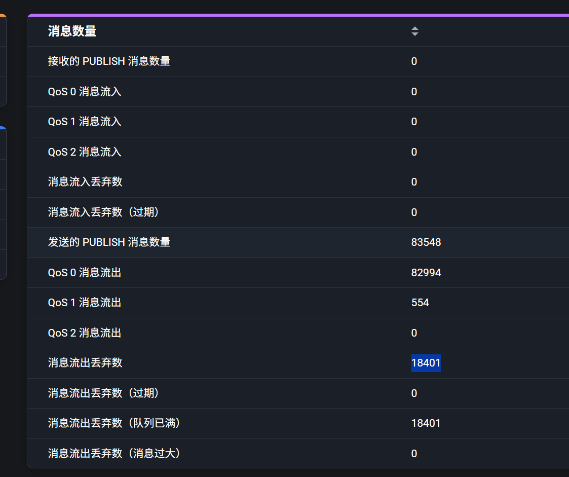

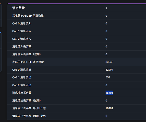

在两种订阅时, 都能观察到mqtt客户端的 消息队列为 1000/1000, 且 ‘消息流出丢弃数’ 大于0.
从 emq 观察, 发现到: 因为消费缓慢导致client会被强制断开,重连.

能看到消息流出丢弃数(队列已满)
这是 消息消费端.

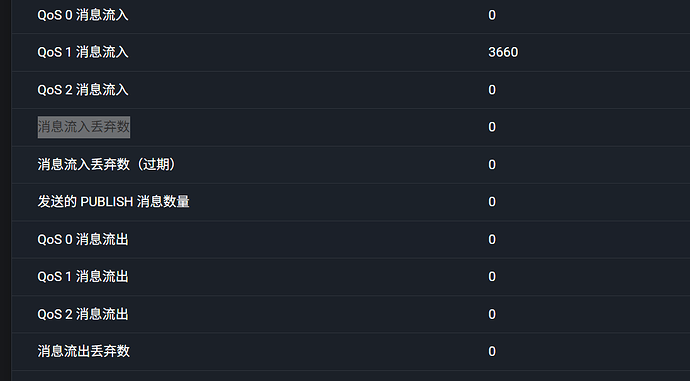

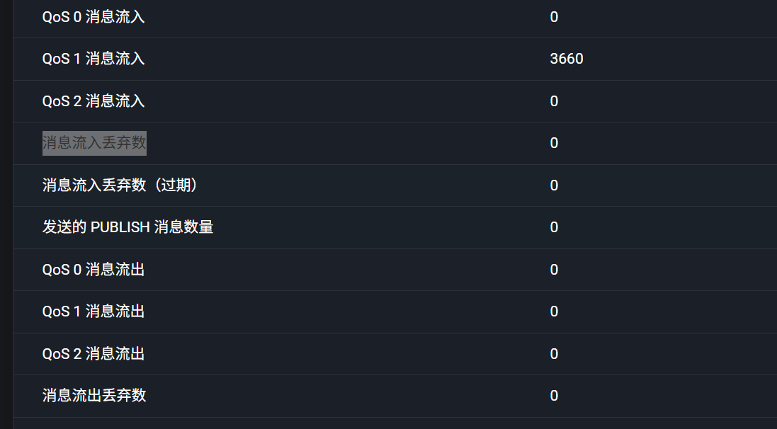

发布端会丢消息吗? 它只有发布不成功吧
会,比如说没有人订阅这种最简单的情况。
按你的说法单个客户端能消费一万二,三个客户端每个只消费4000,还是队列满,这个确实很奇怪 我也不知道什么原因
发布端丢消息, 就是 消息流入丢弃数 吧.

2025-12-29T17:03:15.848867+08:00 [warning] msg: dropped_msg_due_to_mqueue_is_full, mfa: emqx_session:handle_dropped/3, line: 644, peername: 172.10.1.7:36969, clientid: mqtt2kafka-client-4410945490694820, topic: dev/monitor/301323120124, payload: #{extra => ,flags => #{dup => false,retain => false},from => <<“301323120124-0ed5d6e6”>>,headers => #{peerhost => {172,10,1,7},properties => #{},proto_ver => 4,protocol => mqtt,redispatch_to => {<<“mqtt2kafka”>>,<<“dev/monitor/#”>>},username => <<“xxxxxx”>>},id => <<0,6,71,19,119,140,35,71,67,98,113,0,26,27,18,35>>,qos => 1,timestamp => 1766998795887,topic => <<“dev/monitor/301323120124”>>}, queue: #{dropped => 1502,len => 1000,max_len => 1000,store_qos0 => true}
2025-12-29T17:03:24.288969+08:00 [SOCKET] mqtt2kafka-client-liuwei-4410945490694820@172.10.1.7:36969 msg: socket_force_closed, reason: keepalive_timeout
2025-12-29T17:03:24.302751+08:00 [SOCKET] mqtt2kafka-client-liuwei-4410945490694820@172.10.1.7:36969 msg: emqx_connection_terminated, reason: {shutdown,keepalive_timeout}
