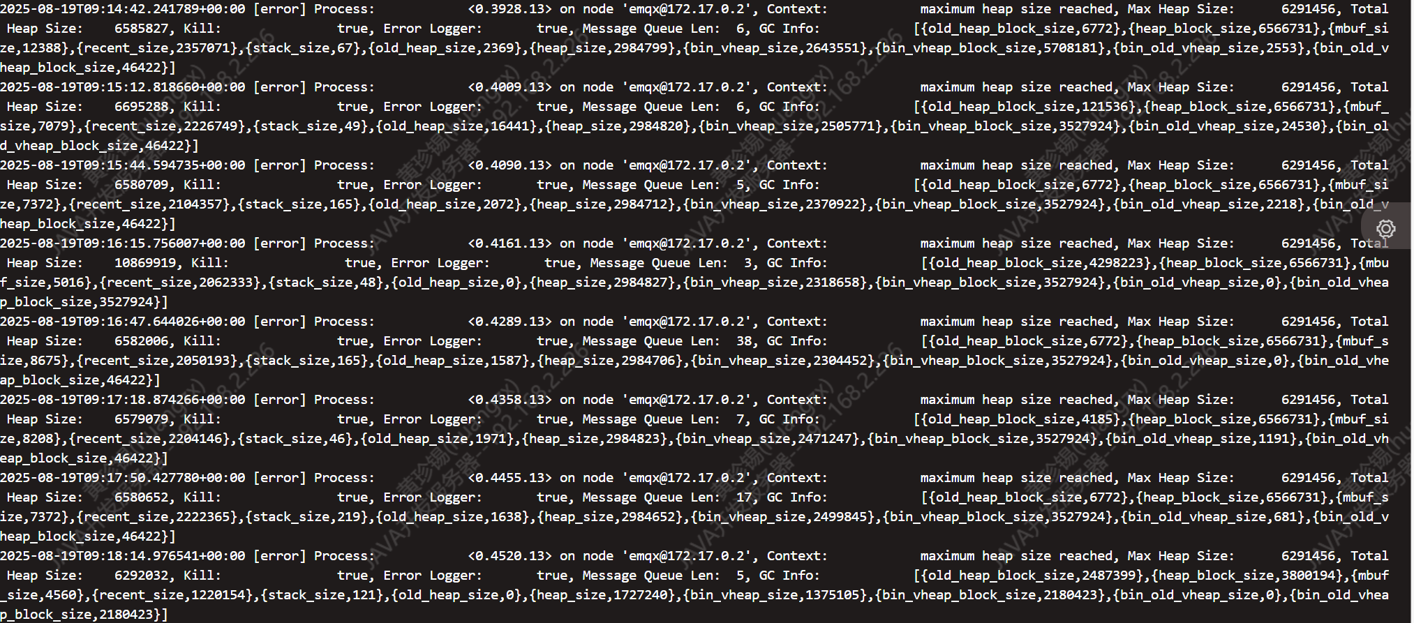

-08-18T08:14:14.024609+00:00 [info] msg: shared_subscriber_down, mfa: emqx_shared_sub:handle_info/2, line: 459, reason: killed, sub_pid: <0.13029.2>
2025-08-18T08:14:14.024552+00:00 [error] Process: <0.13029.2> on node ‘emqx@172.17.0.2’, Context: maximum heap size reached, Max Heap Size: 6291456, Total
Heap Size: 6599993, Kill: true, Error Logger: true, Message Queue Len: 4, GC Info: [{old_heap_block_size,28690},{heap_block_size,6566731},{mbuf_s
ize,4876},{recent_size,2070356},{stack_size,222},{old_heap_size,19314},{heap_size,2984574},{bin_vheap_size,2380536},{bin_vheap_block_size,3527924},{bin_old_vheap_size,9219},{bin_old
_vheap_block_size,46422}]
