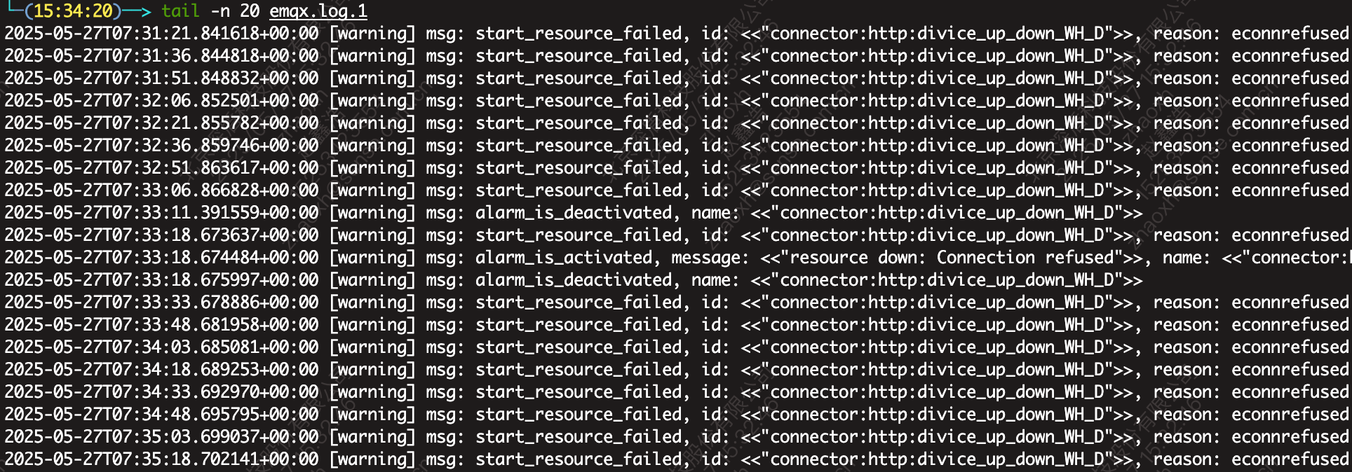

## Actual Result:
Despite the webhook being disabled, the health check logs continue to be flooded.
2025-01-20T08:21:00.780819+00:00 [info] msg: starting_http_connector, mfa: emqx_bridge_http_connector:on_start/2(209), config: #{request => #{path => <<>>,body => undefined,headers => #{'content-type' => <<"application/json">>},method => undefined},ssl => #{depth => 10,verify => verify_none,hibernate_after => 5000,enable => false,ciphers => [],versions => ['tlsv1.3','tlsv1.2'],log_level => notice,secure_renegotiate => true,reuse_sessions => true},description => <<>>,tags => [],connect_timeout => 15000,pool_size => 8,enable => true,headers => #{'content-type' => <<"application/json">>},url => <<"http://host.docker.internal:5001">>,request_base => #{port => 5001,scheme => http,host => "host.docker.internal"},pool_type => random,resource_opts => #{start_timeout => 5000,start_after_created => true,health_check_interval => 15000},enable_pipelining => 100,connector_name => test_WH_D,connector_type => <<"http">>}, connector: <<"connector:http:test_WH_D">>
2025-01-20T08:21:00.799926+00:00 [info] msg: health_check_failed, mfa: emqx_bridge_http_connector:do_get_status/3(621), reason: econnrefused, connector: <<"connector:http:test_WH_D">>
2025-01-20T08:21:00.800365+00:00 [warning] tag: CONNECTOR/WEBHOOK, msg: start_resource_failed, mfa: emqx_resource_manager:start_resource/2(833), reason: econnrefused, resource_id: <<"connector:http:test_WH_D">>

The connectors interface remains enabled for the connector, and it still displays as enabled rather than disabled.

I suspect that the dashboard does not truly disable the webhook's connector(**only disable the action**) when disabling it. If this is the case, it would mean that we cannot disable the webhook's connector via the dashboard; instead, we would only be able to delete it.
Proposal: When clicking disable on the Webhook dashboard, simultaneously disable the associated actions and connectors.
This would ensure that disabling a webhook properly ceases all related activities, providing a more consistent and reliable user experience.
