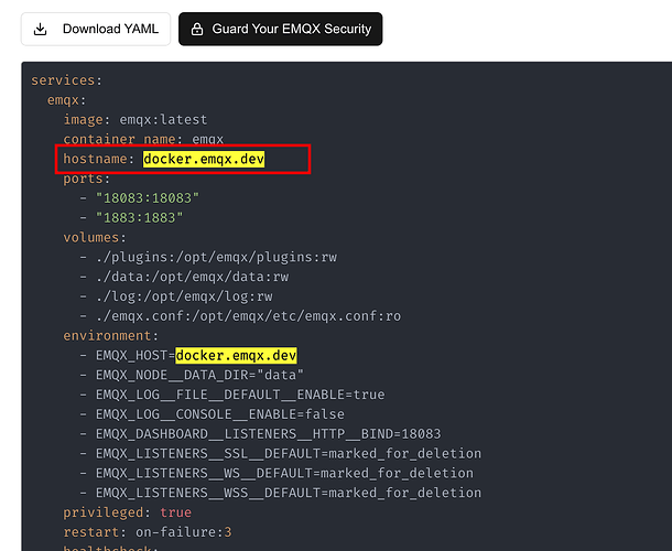

emqx:
image: emqx/emqx:5.8.6
ports:
- “1883:1883”
- “8083:8083”
- “8084:8084”
- “8883:8883”
- “18083:18083”
volumes:
- ./config/emqx-plugins:/opt/emqx/plugins
- ./data/emqx-data:/opt/emqx/data
- ./log/emqx:/opt/emqx/log
- ./config/emqx.conf:/opt/emqx/etc/emqx.conf
environment:
- EMQX_HOST=docker.emqx.dev
- EMQX_NODE__DATA_DIR=“data”
- EMQX_LOG__FILE__DEFAULT__ENABLE=true
- EMQX_LOG__CONSOLE__ENABLE=false
- EMQX_DASHBOARD__LISTENERS__HTTP__BIND=18083
- EMQX_LISTENERS__SSL__DEFAULT=marked_for_deletion
- EMQX_LISTENERS__WS__DEFAULT=marked_for_deletion
- EMQX_LISTENERS__WSS__DEFAULT=marked_for_deletion
privileged: true
restart: on-failure:3
healthcheck:
test: [“CMD”, “/opt/emqx/bin/emqx_ctl”, “status”]
interval: 60s
timeout: 15s
retries: 3
start_period: 90s
sysctls:
net.core.somaxconn: 32768
net.ipv4.tcp_syncookies: 0
net.ipv4.tcp_max_syn_backlog: 16384
net.ipv4.tcp_max_tw_buckets: 1048576
net.ipv4.tcp_fin_timeout: 15
net.ipv4.ip_local_port_range: “1024 65535”
ulimits:
nproc: 1048576
nofile:
soft: 1048576
hard: 1048576
这是启动的配置文件
