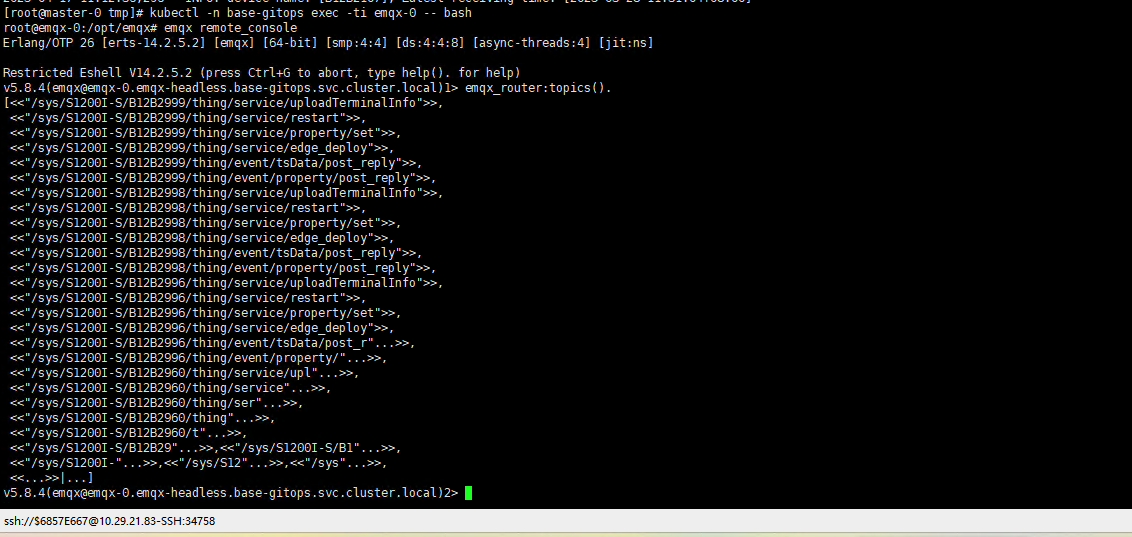

emqx_router:topics().
emqx_router:topics(). 这个命令打印的内容,好像不是很全?怎么才能打印全部的topics?

<<“/sys/DCME2204/000009EB/thing/service/uploadNetSignalStrength”>>,
<<“/sys/DCME2204/000009EB/thing/service/triggerCollectStop”>>,
<<“/sys/DCME2204/000009EB/thing/service/triggerCollectStart”>>,
<<“/sys/DCME2204/000009EB/thing/service/restart”>>,
<<“/sys/DCME2204/000009EB/thing/service/property/set”>>,
<<“/sys/DCME2204/000009EB/thing/service/edge_deploy”>>,
<<“/sys/DCME2204/000009EB/thing/event/tsData/post_reply”>>,
<<“/sys/DCME2204/000009EB/thing/event/triggerData/post_reply”>>,
<<“/sys/DCME2204/000009EB/thing/event/property/post_reply”>>,
<<“/sys/DCME1002/A4440044/thing/service/uploadTerminalInfo”>>,
<<“/sys/DCME1002/A4440044/thing/service/uploadNetSignalStrength”>>,
<<“/sys/DCME1002/A4440044/thing/service/triggerCollectStop”>>,
<<“/sys/DCME1002/A4440044/thing/service/triggerCollectStart”>>,
<<“/sys/DCME1002/A4440044/thing/service/restart”>>,
<<“/sys/DCME1002/A4440044/thing/service/property/set”>>,
<<“/sys/DCME1002/A4440044/thing/service/edge_deploy”>>,
<<“/sys/DCME1002/A4440044/thing/event/tsData/post_reply”>>,
<<“/sys/DCME1002/A4440044/thing/event/triggerData/post_reply”>>,
<<“/sys/DCME1002/A4440044/thing/event/property/post_reply”>>,
<<“/ota/device/upgrade/S1200I-S/28E546F9”>>,
<<“/ota/device/upgrade/DT310/B0510134”>>,
<<“/ota/device/upgrade/DT310/B04C0052”>>,
<<“/ota/device/upgrade/DT300/B0510307”>>,
<<“/ota/device/upgrade/DT300/B0510141”>>,
<<“/ota/device/upgrade/DMS1200T/B2310392”>>,
<<“/ota/device/upgrade/DMS1200T/B2310273”>>,
<<“/ota/device/upgrade/DMS1200I/4ED377FF”>>,
<<“/ota/device/upgrade/DMS1200I/13E51AF6”>>,
<<“/ota/device/upgrade/DMG311/EE031811”>>,
<<“/ota/device/upgrade/DMG2100/EE112237”>>,
<<“/ota/device/upgrade/DMG210/EE112235”>>,
<<“/ota/device/upgrade/DMG1160I/A0000046”>>,
<<“/ota/device/upgrade/DMG1150I/A1210001”>>,
<<“/ota/device/upgrade/DCUA1204/A23C0012”>>,
<<“/ota/device/upgrade/DCUA1004/A2370019”>>,
<<“/ota/device/upgrade/DCUA1004/3B662E6C”>>,
<<“/ota/device/upgrade/DCUA1004/11111111”>>,
<<“/ota/device/upgrade/DCME2204/000009EB”>>,
<<“/ota/device/upgrade/DCME1002/A4440044”>>,
<<“/ext/session/DT310/B0510134/combine/batch_login_reply”>>,
<<“/ext/session/DMG311/EE031811/combine/batch_logout_reply”>>,
<<“/ext/session/DMG311/EE031811/combine/batch_login_reply”>>,
<<“/ext/session/DMG2100/EE112237/combine/batch_logout_reply”>>,
<<“/ext/session/DMG2100/EE112237/combine/batch_login_reply”>>,
<<“/ext/session/DMG210/EE112235/combine/batch_logout_reply”>>,
<<“/ext/session/DMG210/EE112235/combine/batch_login_reply”>>,
<<“/ext/session/DMG1160I/A0000046/combine/batch_login_reply”>>,
<<“/ext/session/DMG1150I/A1210001/combine/batch_logout_reply”>>,
<<“/ext/session/DMG1150I/A1210001/combine/batch_login_reply”>>,
<<“/ext/notify/DMG1150I/A1210001”>>,
<<“/ext/error/S1200I-S/28E546F9”>>,
<<“/ext/error/EDGE-GATEWAY/EGW123456”>>,
<<“/ext/error/DT310/B0510134”>>,
<<“/ext/error/DMS1200I/4ED377FF”>>,
<<“/ext/error/DMG311/EE031811”>>,
<<“/ext/error/DMG2100/EE112237”>>,
<<“/ext/error/DMG210/EE112235”>>,
<<“/ext/error/DMG1160I/A0000046”>>,
<<“/ext/error/DMG1150I/A1210001”>>,
<<“/ext/session/+/+/combine/batch_login”>>,
<<“/ext/session/+/+/combine/batch_logout”>>,
<<“/ota/device/inform/+/+”>>,<<“/rpc-thin/+/e2c”>>,
<<“/sys/+/+/thing/event/+/post”>>,
<<“/sys/+/+/thing/event/property/batch/post”>>,
<<“/sys/+/+/thing/service/+”>>,
<<“/sys/+/+/thing/service/property/set_reply”>>,
<<“/sys/+/+/thing/task/get”>>,<<“/sys/+/+/thing/topo/add”>>,
<<“/sys/EDGE-GATEWAY/EGW123456/#”>>,
<<“$SYS/brokers/+/clients/#”>>]
ok
长度为229
另外一个节点 emqx-1的topics如下:
[<<“/sys/S1200T-S/B2310408/thing/service/edge_deploy”>>,
<<“/sys/S1200I-U/45D57BFF/thing/service/edge_deploy”>>,
<<“/sys/S1200I-S/57CC4BF0/thing/service/edge_deploy”>>,
<<“/sys/S1200I-S/28E546F9/thing/service/uploadTerminalInfo”>>,
<<“/sys/S1200I-S/28E546F9/thing/service/restart”>>,
<<“/sys/S1200I-S/28E546F9/thing/service/property/set”>>,
<<“/sys/S1200I-S/28E546F9/thing/service/edge_deploy”>>,
<<“/sys/DT300/B0510307/thing/service/restart”>>,
<<“/sys/DT300/B0510307/thing/service/property/set”>>,
<<“/sys/DT300/B0510307/thing/service/edge_deploy”>>,
<<“/sys/DT300/B0510307/thing/event/tsData/post_reply”>>,
<<“/sys/DT300/B0510307/thing/event/triggerData/post_reply”>>,
<<“/sys/DT300/B0510307/thing/event/property/post_reply”>>,
<<“/sys/DT300/B0510141/thing/service/uploadTerminalInfo”>>,
<<“/sys/DT300/B0510141/thing/service/uploadNetSignalStrength”>>,
<<“/sys/DT300/B0510141/thing/service/triggerCollectStop”>>,
<<“/sys/DT300/B0510141/thing/service/triggerCollectStart”>>,
<<“/sys/DT300/B0510141/thing/service/restart”>>,
<<“/sys/DT300/B0510141/thing/service/property/set”>>,
<<“/sys/DT300/B0510141/thing/service/edge_deploy”>>,
<<“/sys/DT300/B0510141/thing/event/tsData/post_reply”>>,
<<“/sys/DT300/B0510141/thing/event/triggerData/post_reply”>>,
<<“/sys/DT300/B0510141/thing/event/property/post_reply”>>,
<<“/sys/DMS1200T/B2310392/thing/service/uploadTerminalInfo”>>,
<<“/sys/DMS1200T/B2310392/thing/service/uploadNetSignalStrength”>>,
<<“/sys/DMS1200T/B2310392/thing/service/triggerCollectStop”>>,
<<“/sys/DMS1200T/B2310392/thing/service/triggerCollectStart”>>,
<<“/sys/DMS1200T/B2310392/thing/service/restart”>>,
<<“/sys/DMS1200T/B2310392/thing/service/property/set”>>,
<<“/sys/DMS1200T/B2310392/thing/service/edge_deploy”>>,
<<“/sys/DMS1200T/B2310392/thing/event/tsData/post_reply”>>,
<<“/sys/DMS1200T/B2310392/thing/event/triggerData/post_reply”>>,
<<“/sys/DMS1200T/B2310392/thing/event/property/post_reply”>>,
<<“/sys/DMS1200T/B2310273/thing/service/uploadTerminalInfo”>>,
<<“/sys/DMS1200T/B2310273/thing/service/uploadNetSignalStrength”>>,
<<“/sys/DMS1200I/13E51AF6/thing/service/triggerCollectStart”>>,
<<“/sys/DMS1200I/13E51AF6/thing/service/restart”>>,
<<“/sys/DMS1200I/13E51AF6/thing/service/property/set”>>,
<<“/sys/DMS1200I/13E51AF6/thing/service/edge_deploy”>>,
<<“/sys/DMS1200I/13E51AF6/thing/event/tsData/post_reply”>>,
<<“/sys/DMS1200I/13E51AF6/thing/event/triggerData/post_reply”>>,
<<“/sys/DMS1200I/13E51AF6/thing/event/property/post_reply”>>,
<<“/sys/DMG311/EE031811/thing/topo/add_reply”>>,
<<“/sys/DMG311/EE031811/thing/service/uploadTerminalInfo”>>,
<<“/sys/DMG311/EE031811/thing/service/uploadNetSignalStrength”>>,
<<“/sys/DMG311/EE031811/thing/service/triggerCollectStop”>>,
<<“/sys/DMG311/EE031811/thing/service/triggerCollectStart”>>,
<<“/sys/DMG311/EE031811/thing/service/restart”>>,
<<“/sys/DMG311/EE031811/thing/service/property/set”>>,
<<“/sys/DMG311/EE031811/thing/service/edge_deploy”>>,
<<“/sys/DMG311/EE031811/thing/event/tsData/post_reply”>>,
<<“/sys/DMG311/EE031811/thing/event/triggerData/post_reply”>>,
<<“/sys/DMG311/EE031811/thing/event/property/post_reply”>>,
<<“/sys/DMG2100/EE112237/thing/topo/add_reply”>>,
<<“/sys/DMG2100/EE112237/thing/service/uploadTerminalInfo”>>,
<<“/sys/DMG2100/EE112237/thing/service/uploadNetSignalStrength”>>,
<<“/sys/DMG2100/EE112237/thing/service/triggerCollectStop”>>,
<<“/sys/DMG2100/EE112237/thing/service/triggerCollectStart”>>,
<<“/sys/DMG2100/EE112237/thing/service/restart”>>,
<<“/sys/DMG2100/EE112237/thing/service/property/set”>>,
<<“/sys/DMG2100/EE112237/thing/service/edge_deploy”>>,
<<“/sys/DMG2100/EE112237/thing/event/tsData/post_reply”>>,
<<“/sys/DMG2100/EE112237/thing/event/triggerData/post_reply”>>,
<<“/sys/DMG2100/EE112237/thing/event/property/post_reply”>>,
<<“/sys/DMG210/EE112235/thing/topo/add_reply”>>,
<<“/sys/DMG210/EE112235/thing/service/uploadTerminalInfo”>>,
<<“/sys/DMG210/EE112235/thing/service/uploadNetSignalStrength”>>,
<<“/sys/DMG210/EE112235/thing/service/triggerCollectStop”>>,
<<“/sys/DMG210/EE112235/thing/service/triggerCollectStart”>>,
<<“/sys/DMG210/EE112235/thing/service/restart”>>,
<<“/sys/DMG210/EE112235/thing/service/property/set”>>,
<<“/sys/DMG210/EE112235/thing/service/edge_deploy”>>,
<<“/sys/DMG210/EE112235/thing/event/tsData/post_reply”>>,
<<“/sys/DMG210/EE112235/thing/event/triggerData/post_reply”>>,
<<“/sys/DMG210/EE112235/thing/event/property/post_reply”>>,
<<“/sys/DMG1160I/A0000046/thing/topo/add_reply”>>,
<<“/sys/DMG1160I/A0000046/thing/service/uploadTerminalInfo”>>,
<<“/sys/DMG1160I/A0000046/thing/service/restart”>>,
<<“/sys/DMG1160I/A0000046/thing/service/property/set”>>,
<<“/sys/DMG1160I/A0000046/thing/service/edge_deploy”>>,
<<“/sys/DMG1160I/A0000046/thing/event/tsData/post_reply”>>,
<<“/sys/DMG1160I/A0000046/thing/event/property/post_reply”>>,
<<“/sys/DMG1150I/A1210001/thing/service/uploadTerminalInfo”>>,
<<“/sys/DMG1150I/A1210001/thing/service/restart”>>,
<<“/sys/DMG1150I/A1210001/thing/service/property/set”>>,
<<“/sys/DMG1150I/A1210001/thing/service/edge_deploy”>>,
<<“/sys/DMG1150I/A1210001/thing/event/tsData/post_reply”>>,
<<“/sys/DCUA1004/3B662E6C/thing/event/tsData/post_reply”>>,
<<“/sys/DCUA1004/3B662E6C/thing/event/property/post_reply”>>,
<<“/sys/DCUA1004/11111111/thing/service/uploadTerminalInfo”>>,
<<“/sys/DCUA1004/11111111/thing/service/setUploadLogLevel”>>,
<<“/sys/DCUA1004/11111111/thing/service/property/set”>>,
<<“/sys/DCUA1004/11111111/thing/service/largeFileCollect”>>,
<<“/sys/DCUA1004/11111111/thing/service/deviceRestart”>>,
<<“/sys/DCUA1004/11111111/thing/event/tsData/post_reply”>>,
<<“/sys/DCUA1004/11111111/thing/event/property/post_reply”>>,
<<“/sys/DCME2204/000009EB/thing/service/uploadTerminalInfo”>>,
<<“/ext/error/DMG1150I/A1210001”>>]
ok
length(emqx_router:topics()).
长度为120
概率出现多次,每次的长度会略有变化,但是两个节点的长度都不一样。
可以在 github issue 上更新了,让他们看看,我没法了。 :(
